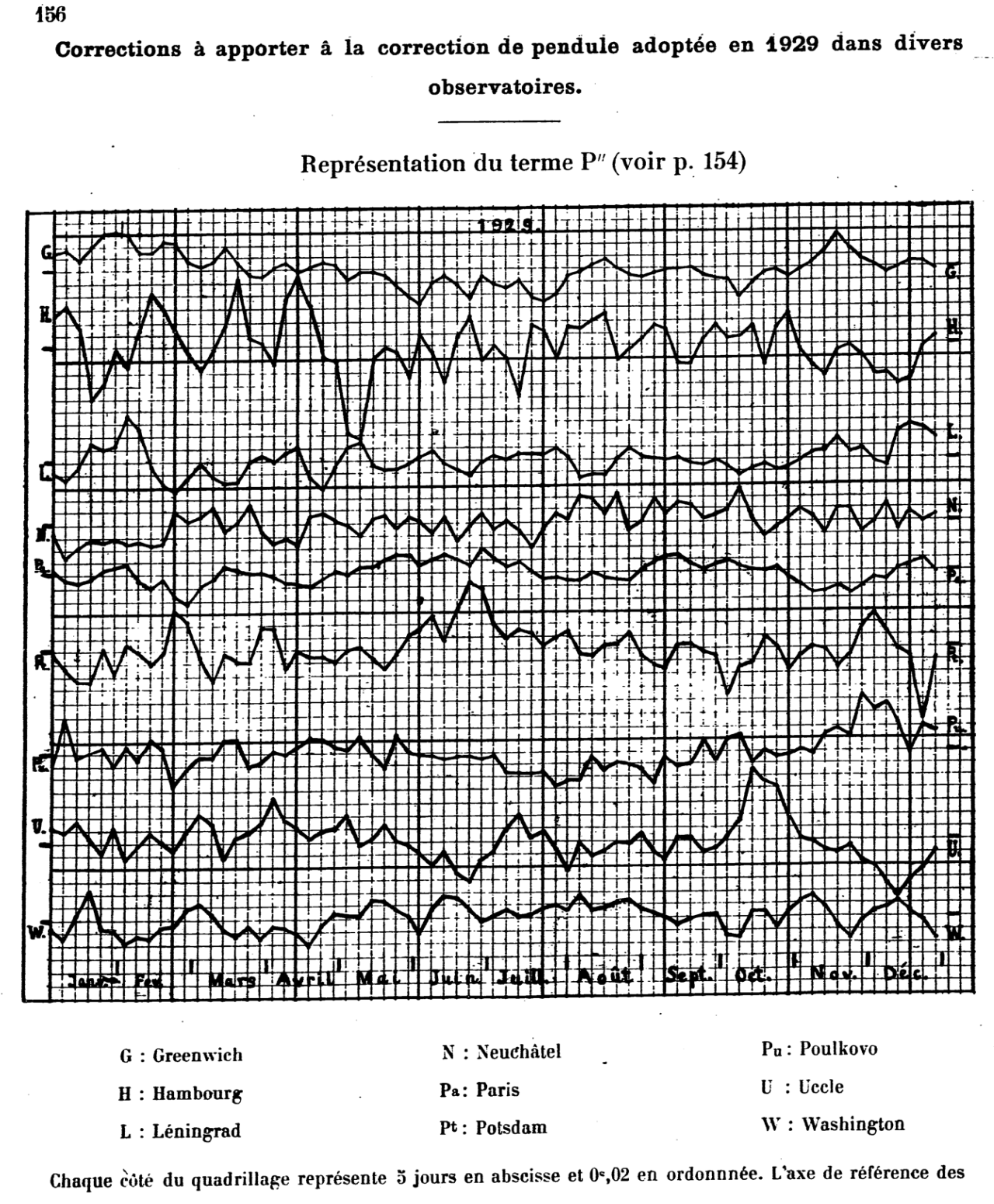

In 1940 the technology of time keeping made a huge leap as the lessons
learned from 20 years of BIH were codified and implemented by
observatories, but before then things were not much different than
the 1929 plot of offsets of the best observatories given in
Bulletin Horaire volume 4 number 56 page 156
https://www.ucolick.org/~sla/leapsecs/BHv4n056p156.png
where it is clear that the time of the best observatories
walked more than 0.1 s during the year.
The legal time of 19m 32.13s would not have been practically available,
and it would have been imprecise by as much as that fractional second.
